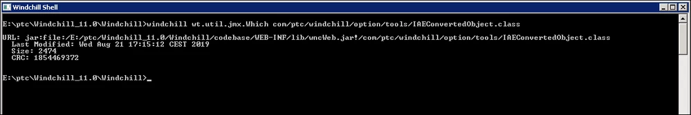

The problem is > Nested exception: java.lang.ClassNotFoundException: com.ptc.windchill.option.tools.IAEConvertedObject
As mentioned in the error this class is not found. If you are doing customization of this part in Windchill, please double check again.
For a quick fix you can search remove the customization that you put in the windchill or add this missing file from a previous backup.

Hi @Arpit-Singh ,
To me it looks like the class in error message (com.ptc.windchill.option.tools.IAEConvertedObject) is OOTB class and not related to @ming3 's customization.
I also found KB article https://www.ptc.com/fr/support/article/cs212750 which refers to same package and same class.
@ming3 do you have any customization around around mentioned class? Make sure your customization source migration dont override/delete/touch any of the OOTB file and you follow Customization best practices.
Please run below command and compare output:
           windchill wt.util.jmx.Which com/ptc/windchill/option/tools/IAEConvertedObject.class
I hope this helps you!
