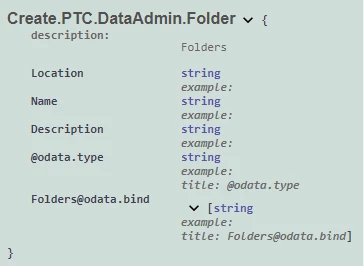

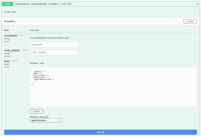

Try to create the folder from a Windchill restApi documentation UI.
You can try it from the UI and you can find if the json is well formatted.
https://serverAdress.com/Windchill/netmarkets/html/wrs/doc.html
examples
"Folder@odata.bind": "Folders('OR:wt.folder.SubFolder:199456')"
"@odata.type": "#PTC.NavCriteria.WTPartStandardConfigSpec",
for the type I would try to find a type for the SubFolder. I guess it could be something like
"#PTC.Folder.SubFolder" but I don't know exactly.

@nbojcetic , @VB_2025784 Please use the Swagger UI to run endpoints, your payload does not contain all necessary data as @HelesicPetr explained.
Also, it could be a permission issue, try to create the folder on the exact context with the same user on the UI; but I guess it's not the root cause.
Aug 22, 2024 1:11 AM UTC
You must enter the default folder ID under the product
POST /Windchill/servlet/odata/DataAdmin/Containers(<oid>)/Folders(<oid>)/Folders
Folders(<oid>) : This is the default folder ID
EX) Containers('OR:wt.pdmlink.PDMLinkProduct:131308')/Folders('OR:wt.folder.Cabinet:131359')/Folders('OR:wt.folder.SubFolder:146353')/Folders"
