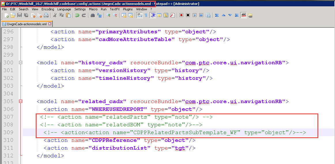

We don't currently use WTParts here (back 10+ years from how things were at Alcon...) and have no current plans.
I'm simplifying Windchill where possible.  Would like to remove the Parts link from CAD Doc, Related Objects tab.  It's a matter of finding the right block in \Windchill\codebase\config\actions\???actionmodels.xml, copying it to custom-actionmodels.xml and then removing.  I can't find the file that has the related objects page definition.  Tech support w/PTC pending for a few days now - the TSE hasn't yet found it either.  Must be something very simple.  Appreciate answers.
thx

Those  actions are defined in \Windchill\codebase\config\actions\infoPage-actionmodels.xml

I was looking there but it didn't seem like the one.  Must be this block.  Not clear which line(s) to comment out.  There is a single "Parts" table on the CAD Doc Related Objects page.

2-Explorer
January 27, 2017
Hi Mike,
I had a second look and it looks like this is where it is defined.
