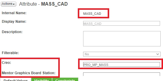

Owner Link Attribute Mapping
is there any OOTB possibility to keep attributes synced on WTPart and EPMDoc, when associated by Owner Link and the Attribute names do NOT match?
Thanks &
Kind Regards

Just restating for clarity. Are you saying on the EPMDoc you have an attribute A that needs to map to attribute B on the WTPart? Any reason that you cannot have them match? It might be easier than customization. I believe there is a way to map CAD attributes inside of the CAD system to parameters on the EPMDocument.  Would that help you?

I just add that you can define the mapping in the type and attribute management for IBA attribute.
you can define a attribute that is used in the Creo/NX/Catia/others that is populated to the EPMDocument attribute in Windchill
Here is an example for MASS_CAD that is populated from Creo PRO_MP_MASS
PetrH
