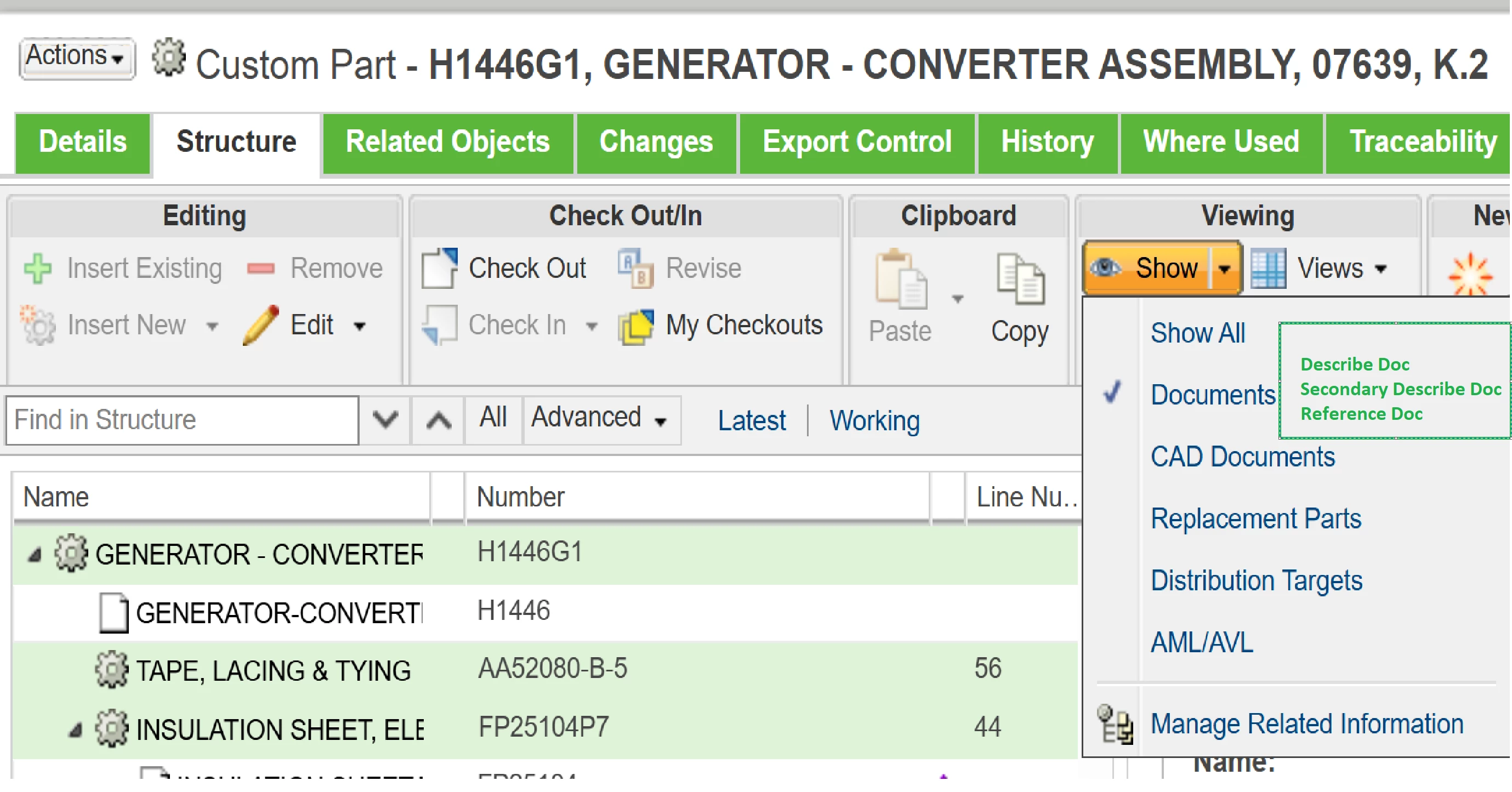

1. Our Windchill version is 12 CPS 17 using PDMLink/ProjectLink etc. Our industry is Aerospace and my role is a Windchill developer
My objective here is below.
In Part Structure tab, user could select the list of child and navigate to Viewing panel --> Show --> Documents, only displays the Describe document & Reference document.
We would like to show the Secondary Described By document as well.
Adding to this, Would be great if we can segregate the actions from Viewing panel --> Show --> (Instead of Documents), add Describe Doc, Secondary Describe doc & Reference doc, so that user can choose the required type and displays doc in the structure

First the PSB is not open for custo as it is based a GWT : https://www.ptc.com/en/support/article/CS165341
But still curios what is meant by "Secondary Described By document "

I was wondering this too. @MN_11503963 - are you referring to Attachments?
May 22, 2025 10:30 AM UTC
Nope, It's not an attachments, It's kind of Describe link document. Just like Describe Doc/Reference Doc
