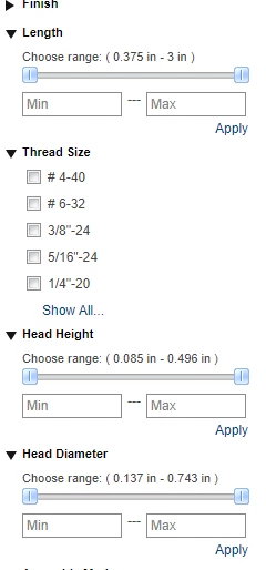

Hi Everyone. I Would love to hear any and all feedback regarding two current hangups on my Attribute and Node layout. First the problems:
1. The Organization would like to give "Parts Link Administration" power to a subset of librarians. This Librarian would be responsible for entering parameters specific to geometry ie: length, size, threads etc... To facilitate this, a "Real Number" Data Type will be used.
Personally I would use a "String" and Legal value list. This list will hold specific values that can then be managed. Question: At your organizations, which direction did you go or how did you handle this?
2. Node structure and layout. How are you handling IN and MM parts? Do you create separate nodes at each level or did you create this delineation at the top level? (see image for node specific example)
thanks for any ideas or input you might have. Maybe I am over thinking this, but I don't want to back myself into a corner. thanks!
Mathew

I used a mix of real number with units and String/legal list. If you want to take advantage of ranges, you'll need real number to get the slider. As for IN vs MM, note that the system will convert units based on user's preferences. You can also define the node that you want to override and prefer certain units for an attribute.  We anguished over each attribute but it picked up speed once we got going. Things like length might make sense a string but you will have an ever increasing list as more parts get added. I recommend keep as real number with units.

This is great. Thank you. Yes, we have been talking about this for weeks. I created a global Enumeration for thread size. Just like you have done:
When you say, "you can also define the node that you want to override and prefer certain units for an attribute", do you mind showing me how you did this? I thought this was a user or site preference and not inside the node. If that's the case, then Real Number w/ Units might be the winner for some of these attributes.
Did you split IN and Metric at the node level?
thanks!  Mathew

Forgive me if I misspoke. I do not have both metric and english cases. when you defined the reusable attribute, you can override units there. It was not at the node level. Users can enter data in any unit they want if they specify the unit suffixes. it will convert properly. all values stored in SI units. Highly recommend you do all of this on a test server before replicating to Prod.
