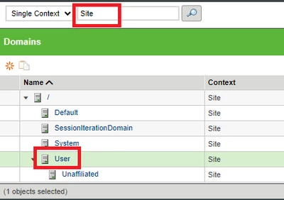

I'm getting the below errors logged while publishing though my publishing is successful. Please help me understand how to resolve this or the only way is to provide the access to the user?
DEBUG [PublisherQueueXXX.PollingThread] wt.access.evaluation.report:2814 Administrator - "xxx" does not have Delete permission for "EPMDoc Config Spec - wt.epm.EPMDocConfigSpec:10593701025" in Administrative Domain "Site /User".
DEBUG [PublisherQueueXXX.PollingThread] wt.wvs.viewmarkup.StandardViewMarkUpService:352 Administrator - ViewMarkUpService: Error postStoreDerviedImage (wt.access.accessResource/19) wt.access.NotAuthorizedException: ATTENTION:  Secured Action. You do not have the necessary authorization for this operation. Contact your administrator if you believe you have received this message in error.

You need to add ACL permission for the user or group or role where user is in.
Object type wt.epm.EPMDocConfigSpec on Administrative Domain "Site /User".
