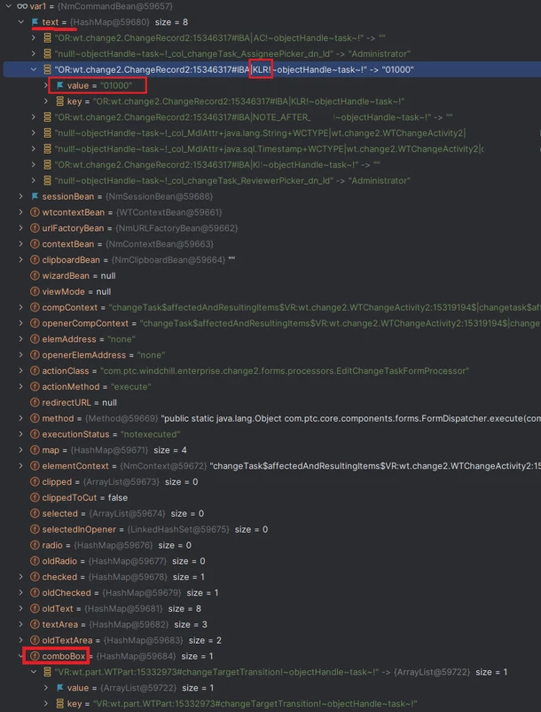

Every information is stored in a NmCommandBean object
in a processor, where is method doOperation or preProcess method contains that object
OOTB doOperation is in EditChangeItemFormProcessor.class

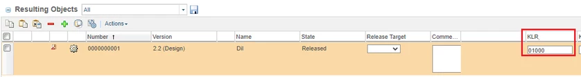

here is example how the information from wizard is stored in the NmCommandBean
example attribute KLR
in the object from the processor code>
Your combo box is in the comboBoxParameter
example how to get comboBox
Map var10 = var1.getComboBox();
