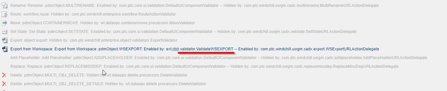

I might be wrong but this is not exactly how I think it should be setup. The command class is what you want to run when they click it but that is not a validator. A validator is something that enables or disables the action as the action dropdown is rendered. What does this action look like when you look at it with jcaDebug=true?

HelesicPetr
January 20, 2025
Hi @WT_010219
Do you know that it is triggered just during a page refresh or Right Mouse Button click on the menu?
How do you know it is not triggered? because it has to be triggered if it is enabled by this validator.
PS> this validator just enable or disable the function during loading. It is not called if user click on the function.
be careful how you call the functions because based on the information's, you expect that the validator is called when user clicks on the function but this way it does not work.
If you need to validate different things like data consistency, then you have to call it from a wizard page or jsp page that is opened with his action.
