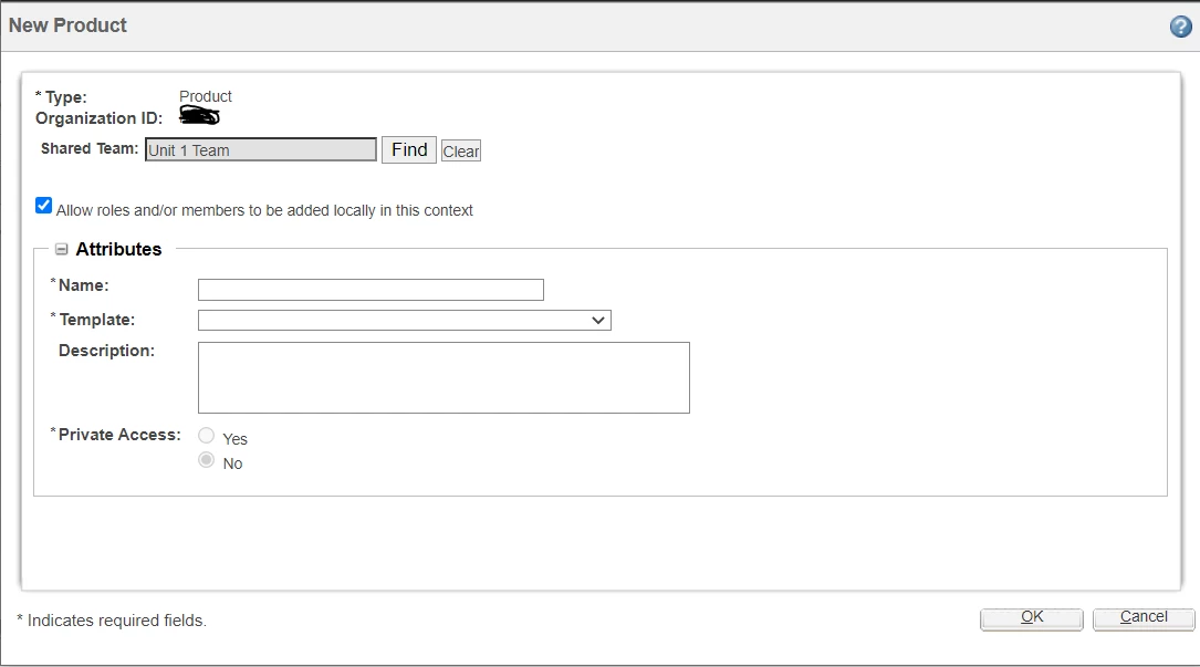

preselect "Allow roles and/or members to be added locally in this context" checkbox creating product
  • October 20, 2021
  • 1014 views
How to change the default value of Allow roles and/or members to be added locally in this context when creating a product/library/project.
The check box should be preselected when using shared team.
durga
October 22, 2021
Hi Durga,
It looks like this is not currently possible - seems to be a hard-coded design choice:
https://www.ptc.com/en/support/article/CS148477
I'd add your use-case and comments to this existing product idea, as others also have the same wish, for this to be available:
https://community.ptc.com/t5/Windchill-Ideas/Option-tab-required-to-replace-the-Shared-Team-for-a-Product-or/idi-p/455813
Mike C.
