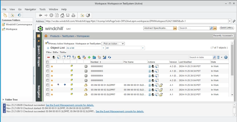

I have programmatically added objects to the workspace and checked them out. However, I am unable to check them back in using the same approach. Could you please suggest any available APIs for checking in objects in the workspace.
Please find the below image for your reference.
I have performed the checkout action using the below code.
wt.fc.ReferenceFactory referenceFactory = new wt.fc.ReferenceFactory();
String workspaceNumber = getWorkspaceNumberFromName();
EPMWorkspace workspace = (EPMWorkspace) referenceFactory.getReference(workspaceNumber).getObject();
if (!WorkInProgressHelper.isCheckedOut(epmdocument)) {
                CheckoutLink chilink = WorkInProgressHelper.service.checkout(epmdocument, workspace.getFolder(), WorkspaceName);
wt.epm.EPMDocument wrk = (wt.epm.EPMDocument) chilink.getWorkingCopy();
System.out.println("Document checked out successfully: " + wrk.getIdentity() +"<-->"+wrk.getNumber());
Nov 27, 2024 6:12 AM UTC
wt.fc.ReferenceFactory referenceFactory = new wt.fc.ReferenceFactory(); String workspaceNumber = getWorkspaceNumberFromName(); EPMWorkspace workspace = (EPMWorkspace) referenceFactory.getReference(workspaceNumber).getObject();
CheckoutLink chilink = WorkInProgressHelper.service.checkout(epmdocument, workspace.getFolder(), WorkspaceName); wt.epm.EPMDocument wrk = (wt.epm.EPMDocument) chilink.getWorkingCopy(); System.out.println("Document checked out successfully: " + wrk.getIdentity() +"<-->"+wrk.getNumber()); }

Dec 2, 2024 5:14 AM UTC
Hello Petr,
If any CAD object added to workspace, then do checkout of that CAD Object it won't allow you do check-in, in the workspace, until unless it has to open in CAD Tool and do save or do some modification in that CAD, then it will allow do check-in. from CAD tool or in the workspace.
This is my understanding correct me if i am wrong.
