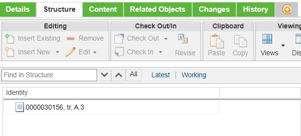

I have a Requirement like this
I need to update an existing WTDocument that is attached to a deliverable within a plan activity. The update involves the following steps:
  1. Replace the currently attached WTDocument with a new one.
  2. Set the newly attached WTDocument as the primary attachment to the previous WTDocument.
  3. Link the newly attached WTDocument as a child document to the previously attached WTDocument.
Please help me solve this requirement.

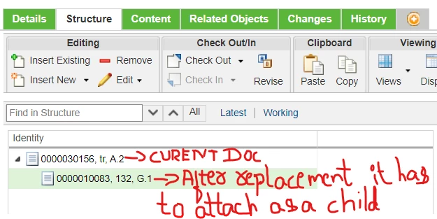

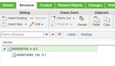

Nov 17, 2024 6:51 AM UTC
Item 2: Yes
Item 3:  as shown in the picture. new document / replacement doc should add as a child of the current doc.
0000030156 (Document Number):  existing doc as deliverable ( no structure at the beginning)
0000010083 (Document Number), new replacement document (after replacement, the new replaced document attached as a child to existing doc )
Nov 17, 2024 7:05 AM UTC
The Below image i have attached this how the requirement, before replacement and after replacement. please help me to solve this, if if you have any code please shar.
