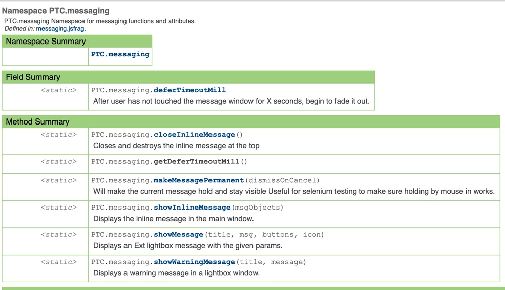

The documentation is in the JSDoc. I think the biggest challenge is finding and throwing the right event.

Thanks found the JSDoc page. Considering this is handled via Javascript, I do not think a server side event can trigger this. It makes sense since this typically appears at the end of some action the user has done. It could be hooked into the home tab but ideally, the goal is to directly them back to this page. It has to balance that line of not being too annoying for users but a gentle reminder so not every time they refresh a certain page. Thanks, this gives me the place to look at a sense or effort. So long as no one else comes along with a canned solution, you'll get credit.
