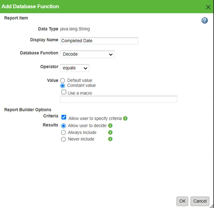

These are the steps I did:
  1. Under Select or Contrain tab, selected Database Function
    1. In Add Database Function modul/popup form
      • Display Name = Completed Date
      • Database Function = Decode
      • Operator = equals
      • Value = Constant value

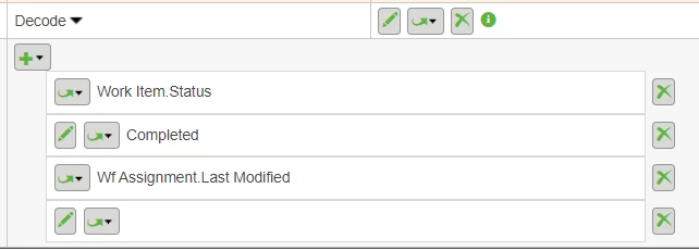

    2. Under Decode dropdown
      1. Add Reportable Item "Work Item. Status"
      2. Add Constant String "Completed"
      3. Add Reportable Item "Wf Assignment.Last Modified"
      4. Add Constant String "" (blank)

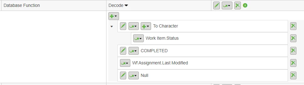

Hi again,
I was able to figure out what was missing. When I would run the report an error was getting thrown about an invalid number.
The result that "Work Item.Status" returns is not a string or a number, its a enumerator.
I was able to add a Database function of "To Character" then under that "Work Item.Status".
After doing this the first value under Database "Decode" can be compared to the second arg which is a string value of "COMPLETED".
