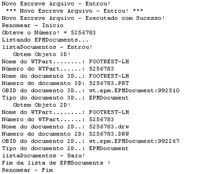

Mar 26, 2024 3:13 PM UTC
I'm able to get 2D EPMDocuments with this code:

My WTPart has three related files, two .PRT files (the original has one but i added another one to test if i can get only the need one) and one .DRW
But the code above return two files. Boths are 2D, and one it's right one, and another was associated to another WTPart. It's one of the things i'm trying to avoid with the another code comparing the names of the objects related.
And i can`t get the 3D`ones with.
There are other way? Some trick or hint?
I tryed a lot of codes differents and without sucess.
Thank you again.

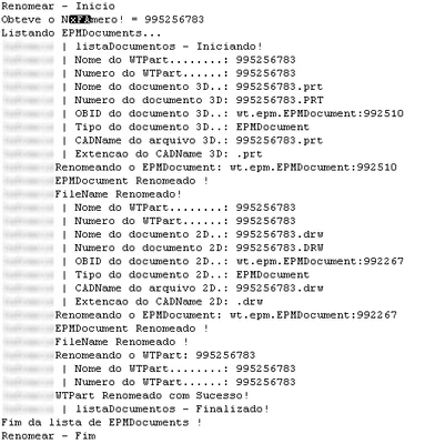

Mar 27, 2024 9:14 PM UTC
News about the development. Now i'm getting both right file names, 2D and 3D.
It´s in my language (portuguese) but you can see i getting the .PRT and .DRW
My challenge is rename them! If anyone can help me, i appreciate.

May 3, 2024 5:56 PM UTC
Hi, just to Close this Topic. I was able to solve the problems.
Follow a image from the right results
Thank you all.
