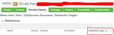

I have a custom table(in a wizard popup by a custom action) which collects all the required dependents of the main EPM and lists them. In the table, I need to have a new column to display the Reference Type between  main EPM doc and the dependent EPM doc.
I tried data utility but I'm not able to get the main EPM doc into data utility as it's called only for each dependent doc.
My requirement is to have a column for Reference Type where each component(row) displays their reference with the main epm Doc as shown in the attached pic.
Any idea or workaround?

Thank you @RandyJones . Do you know how to get the Reference Type value to my custom table. I have two EPMs with CCP Reference Type, I want to have the same column in my custom table.

You can use the EPMMemberLink method getDepType
int depType = epmMemberLink.getDepType();
