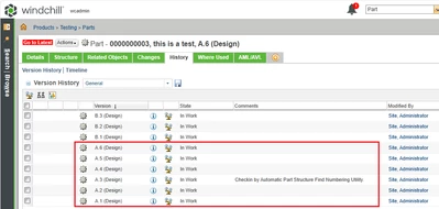

I want to remove the structure from all iterations of Rev A only.  There are six iterations of Rev A

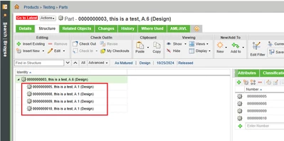

Iteration 6

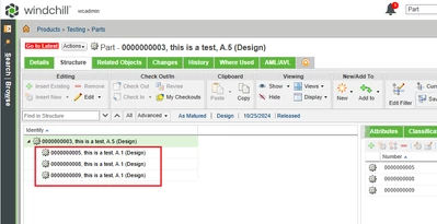

Iteration 5
Iterations 4, 3 and 2 also have a part structure.

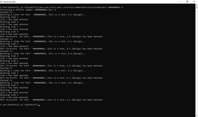

I run the utility in a Windchill shell entering the WTPart's number and revision.
After running note that no WTParts were iterated, but their structures have been completely removed.

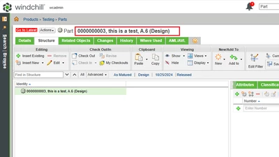

Here's iteration 6 after running the utility.

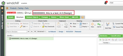

Here's iteration 5 after running the utility.
All gone. 😊
Same is true for the part structures of iterations 4, 3 and 2, all gone.
