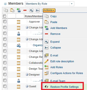

Hi All,
With the same license and groups I can able to see Rename action in WC11 but In WC12 Rename action is disabled with same configuration anything needs to be done?
Best answer by HelesicPetr
Hi @Pushpak
Check the license group if there is not disabled profile with old license
Next try to .reset profile settings on the context
Very often after a upgrade to wch 12+ there is necessary to rearranged the licensees because some are not used anymore for example PDMLink license and so on...
PetrH

Hi @Pushpak
PetrH
April 25, 2023
As Petr mentioned it sounds like a profile. You may want to check your profiles to make sure the rename action is visible
https://www.ptc.com/en/support/article/CS61251
https://support.ptc.com/help/windchill/r12.1.2.0/pt_BR/index.html#page/Windchill_Help_Center/profilemgmt/ProfileMgmtProfileEdit.html
