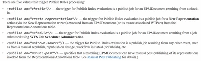

Use Case: Republish is not working - Publish will work only when we do check in and check out. Windchill version is Release: 13.0.2.6 I checked online and tried adding below lines to xml. OR · It says our Windchill version does not support on="republish" or on="manual-post" in publishrules.xml. You cannot fix this by editing XML. To get PDF/STEP on republish, you need either: A check-in/schedule trigger, or A custom workflow/JPO that explicitly calls the publishing API.
<publish on="manual-post" additional-files="publish_drawing"/>
OR
<publish on=" republish" additional-files="publish_drawing"/>
Description:
Attached xml file used. Ca you help on this.

    I don't think `republish` is an option. That's a retriggering of a previously published representation.
    WVS Publish Rules - Enabling Publish Rules :
    Manual post ought to be supported (we're on 13.0.2.1).

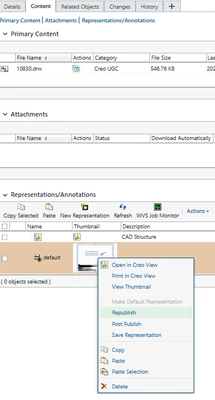

    Thanks for the input and code. I copied your code and did attached new xml file but did republish the file not generating the pdf/step file. Attached copy of xml file. Post publish is not working.
    Post Publishing Succeeded with Warnings
    Warning: there are no additional files in the representation to post publish

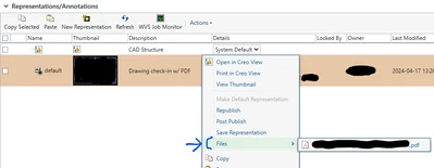

    The pdf/step is generated at initial publish. When it's created successfully, you'll see something like this:
    Republish will just rerun whatever was used previously for that representation. It looks like your additional files aren't getting created. What's your WVS job monitor log look like for this?
