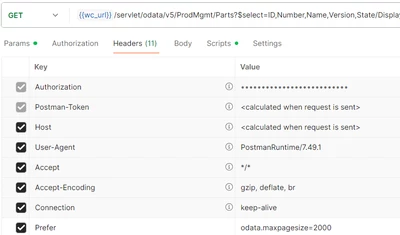

Requesting Large number of objects via WRS Rest API
I am making requests to /Windchill/servlet/odata/v4/DynamicDocMgmt/DynamicDocuments and need to interact with potentially thousands of documents. What we have found is the $top parameter doesn't override the server's page size limit. I also tried a header odata.maxpagesize=1000 but that didnt help either. Any ideas on how to adjust the number of results returned from the API?

Hello @AdamElkins ,
The following way you can be able to get more objects
Prefer : odata.maxpagesize=5000

Check the odata.properties file (located at <Windchill_Home>/codebase/com/ptc/odata/core) no restart needed
