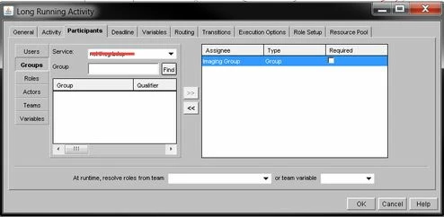

Reset participants of a long running workflow activity
I have a workflow task which is assigned to a WTGroup. When the task is alive, users get added and removed to the group. The workflow tasks which are alive does not reflect any changes made to the group, I tried modifying the wf team and it works only for new tasks not the already existing ones, reassignment through API works but this is not a reassignment so I do not want to use that option. Any thoughts on an API which I can do to refresh the existing tasks? Thanks in Advance.

Hi Binesh,
Did you try the following API to see if that allows you to refresh the team with the group modification and task addition/deletion.
    wt.team.TeamHelper.service.augmentRoles(Obj, wt.team.TeamReference.newTeamReference(wt.team.TeamHelper.service.getTeam(Obj)));
If this works you might want to check if there is a event for  on Group modification and try a listener.

Thank you Sergey.
Unfortunately, the PBO I am dealing with is AbstractWP, not  a VersionableChangeItem.

Hello Bhushan,
Thank you for the reply.  augumentrole API didn't update the tasks assignment, I am wondering this is because the task is assigned to the group instead of a role
