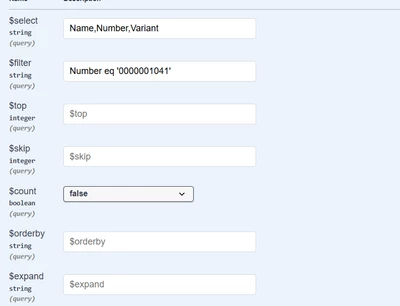

Use Case: How to navigate from part to module variant in rest API I have tried using these links.But there were no results. https://www.google.com/url?sa=t&source=web&rct=j&opi=89978449&url=https://support.ptc.com/help/windchill_rest_services/r2.3/en/windchill_rest_services/example_prodmgmnt_variant_spec_read.html&ved=2ahUKEwi-ntqrjrqNAxXnjGMGHacAJloQFnoECBwQAQ&usg=AOvVaw0azbgXuQK3OZWqhdPAKQ6f
Description:
Could you please help to navigate this downstream .

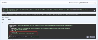

What version you are using ? I tried and it Brings empty result on 12.1

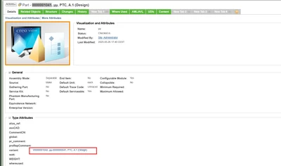

as workaround you can create an alias attribute of datatype Object Reference with mapping
roleBObject@com.ptc.wpcfg.variants.GenericVariantLink~roleAObject^wt.part.WTPart
This will show the variants on the info page of configurable
Later you can query the alias attribute in Rest using classic get Parts
