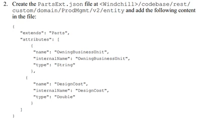

I have soft attributes defined on the WTPart and I would like to retrieve their values. But going through REST Guides and browsing and searching through PTC support site I did not fine single example how to accomplish that. Am I missing something or REST query cannot be used to retrieve soft type attributes? Does any body have any suggestion?

well, it's my fault I should read manuals more carefully. In short, there is a section explaining how to extend domain so a soft attribute can be retrieved.
