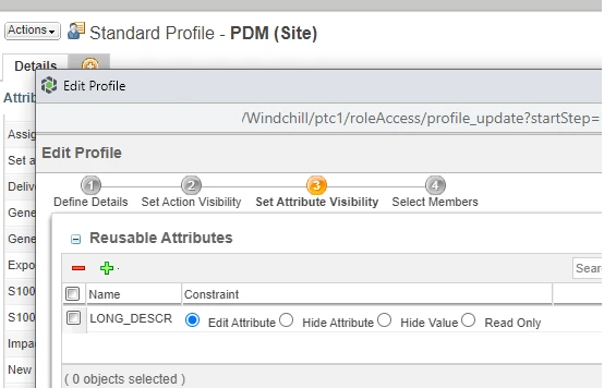

I need to restrict the attributes on my edit page to different users. For example, while I cannot see some attributes for user X, I want user Y to see all of them. How can I make this distinction?

Hi @smcvr
If you need to restrict the access to IBA attributes, you can do it by profiles.
Set own profile to one group, and another own profile to second group of users
You can set what user can do or see. Attibute or just value, atc.

Hi @smcvr

Thanks @HelesicPetr  I solved my problem with your answer 🙂
