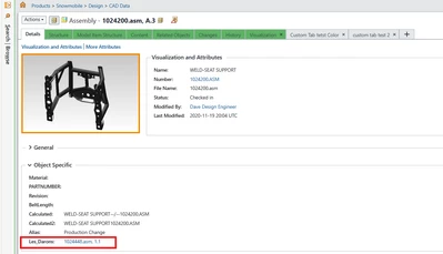

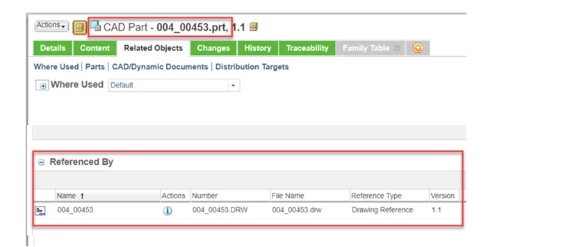

In fact I want retrieve the EPMDcoument which uses the given one. Ex: Given an EMPDocument representing a Creo part, I want retrieve all CREO assemblies which use it.
Fadel
23-Emerald II
Mar 25, 2025 4:36 PM UTC
is there a requirement to use Rest , this can be done OOTB using alias attributes
On the EPMDoc type create an Object Refeerence alias attribute with mapping masterReference@wt.epm.EPMDocumentMaster~uses@wt.epm.structure.EPMMemberLink~usedBy^wt.epm.EPMDocument
This will show the parents are links on the info page :
and you can query the attribute dierctly in Rest .
