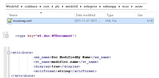

You need to add this to the msoimap file on your server.
Backup your files before making any changes!!!!!!!
XXXX\Windchill\codebase\com\ptc\windchill\enterprise\nativeapp\msoi\server\msoimap.xml
in the <type key="wt.doc.WTDocument"> section you have to add
<attribute>
           <ms_name>Doc ModifiedBy Name</ms_name>
           <wt_name>modifier.name</wt_name>
           <display>true</display>
           <attrFormat>string</attrFormat>
</attribute>
No need for MS resetart etc. Just open doucment again from WC and you should see new attribute "name" this is the last person who modified the doc last.
Check out this PTC article it explains a lot more about the msoimap file.

Dec 14, 2017 11:12 AM UTC
Thanks for your reply. I have already attempted this method and it doesn't seem to work for me. The support team have also looked at my updated msoimap and cannot work out why it is not giving me the results I need. Thanks for the help.
