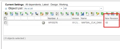

I want to enter values manually while version syncing. Is there a method to this?

Could you be a bit more specific?
Are you talking about picking revision values manually? Or updating attributes manually?
smcvr15-MoonstoneAuthor
May 5, 2023
Hi @Dobi ;
When I want to version, I want to manually set the value in the red field.
For example here it goes from the first version to the second version. I don't want to skip this version like this. When I enter the value 5 in the New Version field, I want it to go to the fifth version.

This is possible in a limited way in a workspace and there is a preference to enable manual setting of revisions:
Users can create parts and cad docs in a workspace and if they upload only, they can revise items before first check in to advance them to a later starting revision. This takes extreme forethought and after check in, options are limited to address.
The preference above should allow a drop down to pick a revision from the series on revise of an existing item. I would test that before deploying. Its a lot of power in users hands to make a mess.
