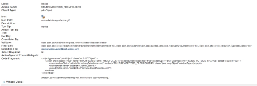

We would like to disable Revise action from Folder Browser's action if certain condition doesn't matches our expectations. It can be achieved through Object's Details page, But couldn't perform the same in Folder Action.
Or else, Throwing explicit exception while revising the object from Folder Browser would also be fine. Please suggest your opinion dear friends!!

Thanks for your suggestion. The concern here is We had extended the ReviseValidator OOTB class for our custom class and chosen the selector of that specific Folder revise action, still it only calls performFullPreValidation method.
On Run-time, so far, it's not possible for us to hide/block the action while revising from Folder browser.

I would suggest to create own validator not extended and configure your validator in customaction.xml
add your validator to the filter element
<action name="MULTIREVISEITEMS_FROMFOLDERS" checkaccess="true" enabledwhensuspended="true" renderType="PDM" selectRequired="true" uicomponent="REVISE_OUTSIDE_CHANGE">
 <command windowType="popup" class="java.lang.Object" method="MULTIREVISEITEMS_FROMFOLDERS" onClick="validateSomethingSelected(event)"/>
 <includeFilter name="disableForAdminLocked"/>
 <includeFilter name="disableForPartToCadBuildAdminLocked"/>
 <includeFilter name="myOwnValidatorRegistredInserviceproperties"/>
</action>
