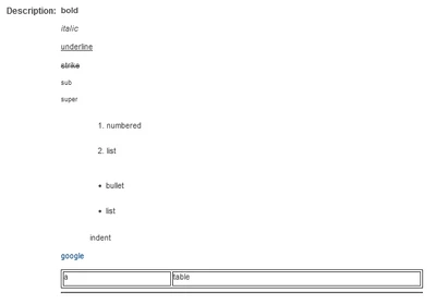

This is great, I took it a step further using regex to apply limited formatting so a multi-line description comes out in plaintext as multi-line

 String plainTextDescription = htmlString
 .replaceAll("(?i)<li[^>]*>", "\n- ") // Add a dash and a space before list items
 .replaceAll("(?i)<tr[^>]*>|<td[^>]*>(?!&nbsp;)", "\n") // Newline before table rows and non-empty table data
 .replaceAll("(?i)<p[^>]*>", "\n") // Insert newline before each paragraph tag
 .replaceAll("<[^>]+>", "") // Remove all HTML tags
 .replaceAll("&nbsp;", " ") // Replace HTML non-breaking spaces
 .replaceAll("\n+", "\n").trim(); // Remove multiple newlines and trim whitespace
