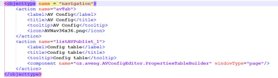

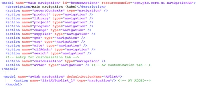

Hi @SD_10008359
I guess that there could be miss spelling in a name of the action or somewhere.
In my case I've added the navigation tab now. So there should not be any trouble with it.
in my case
actionModels.xml
actions.xml
 Result:

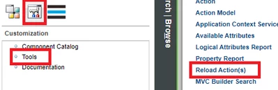

If you use Tools customization tab, you can just reload Actions, if not restart method server.
