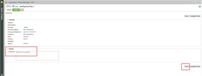

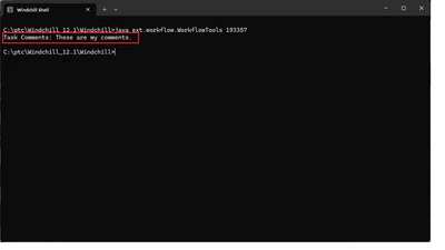

18-Opal
Jan 27, 2026 12:12 PM UTC
Is this what you're looking for.
I created a test workflow and entered a value in the comments field.  I then hit the "Save" button.
Next, I ran code that prints out the saved comment as it is stored in the dB table/column.
