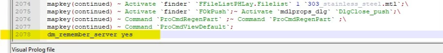

I'm using Creo 5 with Windchill 11 and when I open Creo, type in my Windchill username/password, I always have to navigate to "Server Management", right-click on the server and un-check the "work offline" box. Does anyone know how to have Windchill automatically start online when it opens? I've talked with other folks in the office and theirs automatically starts online and they never need to go to server management and un-check that "work offline" box. We are all using/connecting to the same server. I understand it's not a long process to go to Server Management and just un-check that box but was curious as to why I need to and theirs is online by default.

Try this line in your config.pro:
dm_remember_server yes
July 29, 2021
I did check that and it is already set at "yes".
I apologize, I meant to put in the original post that I had already set that config option. This was my very first post.
July 29, 2021
Additional Info:
I did try deleting the server from Server Management. I then closed Creo and reopened. When I reopened, the server was automatically re-added and I was also already online. Just to make sure it stuck I closed down Creo again and reopened. I then went back to Server Management and it was back to being offline.
