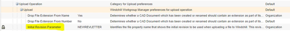

Can Creo utilize the OOTB Windchill property 'Initial Revision Parameter'?
We are using it with SolidWorks to create new family member instances at the same revision as the generic file.
Kind regards,
Dmitry.
