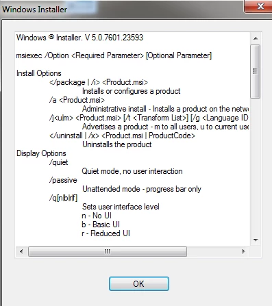

Aug 23, 2017 7:56 PM UTC
i have tried couple things, my current command is...........
Creosetup.exe /vADDLOCAL="ALL" LICENSESERVER=”7788@staeng02” APPLICATIONFOLDER="C:\Program Files\PTC\Creo 4.1\View" /v/l*v "%TEMP%\creoview41_install.log" /qn
but it keeps coming up with the Windows Installer per below screenshot, i click OK, nothing happens.  Any suggestions to make it work?
Aug 23, 2017 8:25 PM UTC
The logging callout is wrong.
Try /l*v "%TEMP%\creoview41_install.log" instead of /v/l*v "%TEMP%\creoview41_install.log".
Also, the error may be from one of the prerequisite programs failing.  The options changed slightly from the older version of the redestributable libraries ( the VC2008, VC2010, etc.).  The older installs used /qn, and the newer ones use /quiet.  Check your CreoSetup.ini file for COMMANDLINE= options as they may be wrong or there is a typo.  I believe the options listed in my example should work.
You don't need to specify the APPLICATIONFOLDER= unless you want it to be different than than the default.
We set the licenses, along with other settings, in the admin_prefs.xml file, so we don't include it on the install line.
Aug 24, 2017 2:59 PM UTC
You were right, /l*v "%TEMP%\creoview41_install.log" worked.   Once I corrected that, Creo View 4.1 installed perfect!
