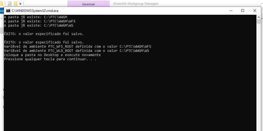

Hello ,
I need to install Windchill-Workgroup-Managers and silent mode , I've tried everything but it doesn't go , someone did this could help me I already put in the script /S, /quiet, /silent, /qn and without success

MS_Santos15-MoonstoneAuthor
Sep 20, 2024 12:56 PM UTC
Yes, but it's giving me an error, I've tried installing it with the local administrator user of the machine, but it's still giving me an error. I need to put it on several machines.

set "folderPath4=%USERPROFILE%\Desktop\MED-60707-CD-130_13-0-2-0_Windchill-Workgroup-Managers"
REM executar o instalador precisa estar no Desktop
if not exist "%folderPath4%" (
    echo Coloque a pasta no Desktop e execute novamente
) else (
%folderPath4%\setup -progressbar -xml xml\mcad_swx.p.xml -xml xml\uwgm.p.xml -xml pim\xml\qualityagent.xml PIM_DEBUG=1 PIM_LOG_ENV="%folderPath4%" -destination "C:\Program Files\PTC"
pause

My help desk colleagues, who also prepare PCs for users, use a centralized system for installing new or upgrade packages.
For those from PTC (CreoView, Creo Platform Services or Windchill Desktop Integration) they use a command like the one below.
setup.msi /qn /norestart
My guess is that your problem could stem from rights, but you only wrote that it doesn't work with the error message in Portuguese so it becomes difficult to go into more detail.
