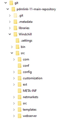

We have four environments DEV/TEST/QA/PRD. For each environment we have parallel GIT repository. Rehost is very common to make sure it will work on prod.
I follow the Windchill folder structure for code management.
  • src : for all source code changes
  • wtsafearea : new and changed windchill files like jsp
  • wtCustom : custom states
  • load files : everything custom that can be loaded , through load from files or manually through UI
  • other parallel Windchill folder structure which deploy customization doesn't support e.g. conf/wvs.agent.ini
Deployment is simple. Copy all the changes from GIT and deploy to Windchill. We use ant to deploy majority of the stuffs.

Curious about your GIT integration. It seems like your Dev environments have Windchill loaded. How much of that do you manage in GIT? Is it just source or are you managing compiled classes to? Here is an example of mine. I've tried to be religious about linking Jira issues to commits in BitBucket. I think I need to amend my steps to pull from repository not from local compiled classes in Eclipse. I can see potential for error here or at least create a separate build environment. Just might be too much overhead for my small operation.
