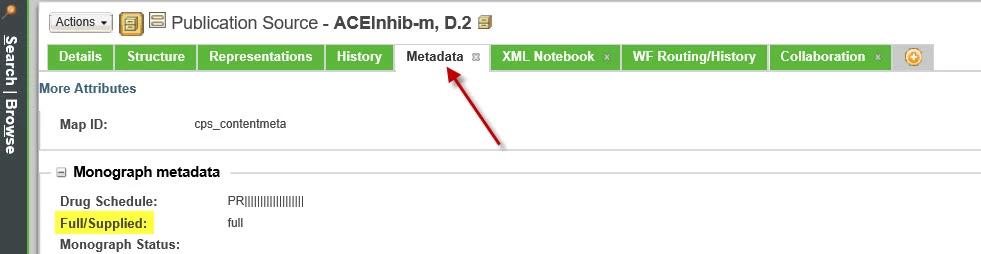

May 17, 2019
it would the 'more attributes' tab in the document information (we renamed to say Metadata)
(see attached screen shot from windchill document i )
which sql table stores this information?
