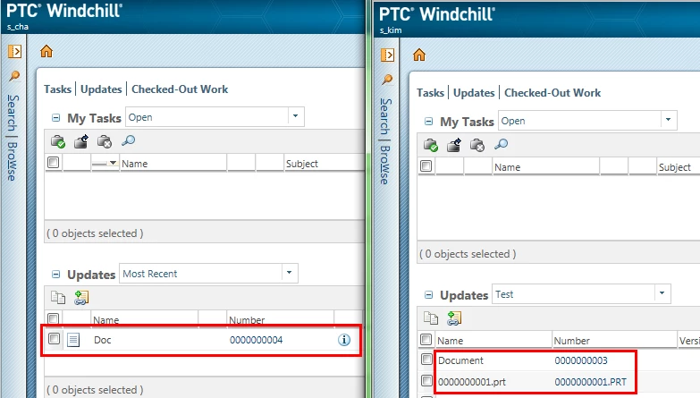

As shown in the figure, the PDMLink OOTB only displays update notices for users.
However, I want some users (product manager, etc.) can check the checked-in objects (documents, EPM documents). Even if it is an object that is not associated with a user!Image1.png

@JHall I want all of the displayed on the objects that the user checks in.
Currently , only the objects checked in by the user himself or checked out can be checked.
From the manager's perspective, he wants to know all the check-in and check-out situations that occur in the product or organization he belongs to.
As a result, administrators should be able to view all updates from other users.
All means only the products or organizations that belong to you.
