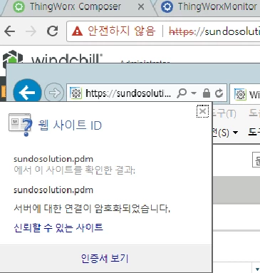

I configured SSL & HTTPS using CS159762
But IE and Chrome are both not safe!
I installed it on a trusted root certificate authority through View Certificate in IE.
After that, the certificate status shows "This is a valid certificate."
But Chrome is still marked as unsafe!
Why is not it safe?
When configuring SSL & HTTPS, can not it be self-signed to be marked safe?
Thank you
Note openssl.cnf has not been modified

Hi
Self signed certificate is not safe for most ( all ? ) browser. This is not related to Windchill.
You need a valid cert from Certificate Authority.

List of certificate auhtority
We use COMODO at our company, but you can use https://letsencrypt.org/ ( it's free )
