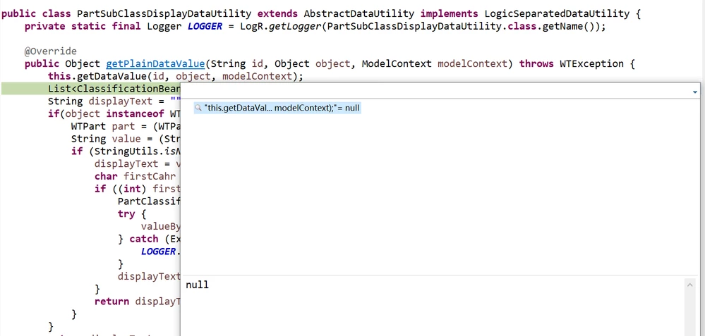

I defined a datautility to control the display text of some Attributes, but when I looked on the attribute tab of the structure Tab, I didn't see it as I saw it on the main attribute page(first Tab). When I debug the attribute of the structure tab, I found that it would enter the getPlainDataValue method of DataUtility. But the first parameter to this method is just the id of the registered datautility instead of the normal component id, so how do I get the original value of the component with datautility set?

You need to implement  LogicSeparatedDataUtility
public class MyDataUtility extends AbstractDataUtility implements LogicSeparatedDataUtility
Then you can use method in your DU
public Object getPlainDataValue(String columnName, Object rowObject, ModelContext modelContext) throws WTException
return ((ConfigPropertiesItem) rowObject).getFileName(); // own object where filename is return as a string
Just use the original function in the getPlainDataValue and convert the value to a String that is shown in the structure
this.getDataValue(columnName, rowObject, modelContext);

I tried it your way. I couldn't get anything.The ID is still the ID of datautility.As an alternative, I'm going to define multiple DUs, each configured to a fixed attribute.

the gerDataValue needs to be defined in you class, and you need to get the values.
String id is the attribute ID Object is the row object that is shown, and ModelContext is where the other information from the browser are stored.
From that you need to get value what you need by your code.
