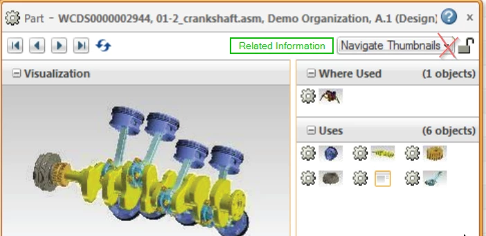

Use Case: How to customize the Thumbnail Navigator in order to show the buttons 'navigate Thumbnails' and 'Related Information' besides each other and not as in the ootb-way where one hides the other?
Description:
Since either 'Related Information' or 'Navigate Thumbnails' is constantly hidden and users (!) don't remember what they don't see, I wanted to make both buttons visible at the same time, as alternatingly pressed/unpressed buttons. Small fix, huge transparency improvement.
Well, the question is now about which file to customize...?
It seems to end up all in the huge ...netmarkets/javascript/util/ext-and-extensions.js , but I suspect that this is not the 'real' source which we would want to customize...
I also think it's not 'officially' supported for customization, but nevertheless the layout must be defined somewhere...
Has anybody a hint or an idea?

Jan 21, 2026 8:36 AM UTC
This is not possible (at least not in anu easy way) .The details are hard coded in miniNavigator.jsfrag in a way that defies easy customization

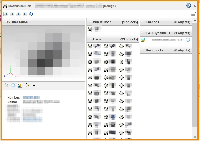

here is a patch file for miniNavigator.jsfrag (I am still using Windchill 12.0.2.26):

this results in a kind of hacky displayed two pane navigator:
including a lot of broken functionality  - don't click on the +/- buttons in order to collapse the panes, it won't expand them 🤪
The scroll bars are also a bit buggy, that's why they are always displayed. But navigating part structures is working great.
(It may eat a bit server performance, though...😇 )
Many thanks for the hints 👍👍

 //this has to map the same id as defined in RenderInfoPageModelTag in getDataValue for nmActions.
 var defaultText = bundleHandler.get("com.ptc.core.ui.navigationRB.MININAVTHUMBPANE");
 var menuButton = {
+ style: {
+ // hide the menu
+ display: "none",
 xtype: "dynamicMenuButton",
 cls: "miniNavTitle",
@@ -668,12 +674,58 @@
 /* Card Manager for right side pane in miniinfo*/
 var miniCardManager = {
- id: PTC.miniNavigator.cardManager,
+ // hide it via id not associated but still execute it, since it is needed
+ // id: PTC.miniNavigator.cardManager,
 layout: "card",
 region: "center", //cannot set autoscroll here (will cause double scrollbar in Chrome). its already set on whereusedPanel/relatedInfopanel
 activeItem: 0,
 portalManager: portalManager,
 items: [whereusedPanel, relatedInfoPanel],
+ // DEV make a combined panel, but this breaks some of the functionality in the ui
+ // important to define this _after_ var portalManager
+ var combinedPanel1 = {
+ id: PTC.miniNavigator.cardManager,
+ xtype: "panel",
+ region: "center",
+ layout: "hbox",
+ layoutConfig: {
+ align: "stretch", // stretch children vertically
+ defaults: {
+ border: false,
+ items: [
+ // LEFT COLUMN (Navigate Thumbnails)
+ id: "in_combinedPanel1_1",
+ xtype: "panel",
+ layout: "fit",
+ flex: 1, // take half of available width
+ style: "padding-right:0; border-right: 1px solid #d1d3d4;",
+ items: [miniCardManager.items[0]],
+ // RIGHT COLUMN (Related Info)
+ id: "in_combinedPanel1_2",
+ xtype: "panel",
+ layout: "fit",
+ flex: 1, // take the other half of the width
+ bodyStyle: "overflow-x:hidden;",
+ style: "padding-left:0; border-left: 1px solid #d1d3d4;",
+ // DEV workaround via https://stackoverflow.com/a/22376259
+ // directly add css here which selects and styles the _generated_ DOM
+ html: [
+ '<style type="text/css">',
+ "#in_combinedPanel1_2 .x-panel-body.x-panel-body-noheader.x-column-layout-ct",
+ // "{height: 100%; overflow-x:hidden; overflow-y:scroll !important;}",
+ "{height: 100%; overflow-x:hidden; overflow-y:scroll !important;}",
+ "</style>",
+ ].join("\n"),
+ items: [miniCardManager.items[1]],
 var dynamicDocPanel = {
@@ -830,7 +882,9 @@
- miniCardManager,
+ // miniCardManager,
+ // DEV add a new panel which contains both mini navigator and related info
+ combinedPanel1,
 WVSPopup.win.on("afteraction", PTC.miniNavigator.onAfterAction);
@@ -875,6 +929,7 @@
 items: [
+ // DEV this contains EACH panel in the relatedinfo panel: caddocs, changes, etc.
 xtype: "miniNavPortalColumn",
@@ -1751,6 +1806,8 @@
 PTC.miniNavigator.isRelatedWidgetPaneOpen = function () {
 var cardManager = Ext.getCmp(PTC.miniNavigator.cardManager);
+ // DEV return true always in order to display the panel always
+ return true;
 return cardManager.layout.activeItem.id === PTC.miniNavigator.relatedInformation;
