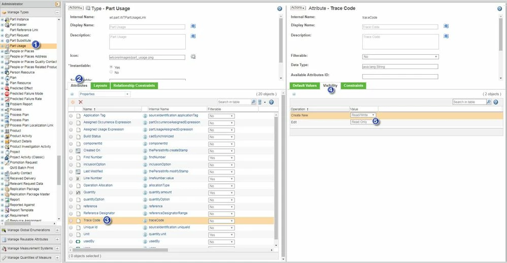

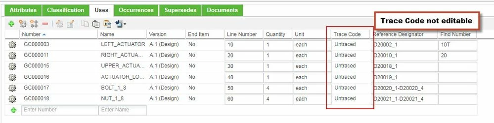

Is it possible to make the value in the Trace Code Column of a structure non-editable?

Hi @Alex1988,
Yes. You can do it.
From Type & Attribute Manager select Part Usage > Select Trace Code attribute in Attributes Tab > On right side, select Visibility.
And for Edit select Read Only. Refer below screen capture.
I hope this helps you.

Hi @ShirishMorkhade_238755,
Glad to know that this is possible with OOTB setting. I was suggested to write a code for for similar stuff.
After reading this post, I am able to achieve my use case with OOTB setting.
Thanks a ton Smiley Very Happy you rocks... best of luck!
