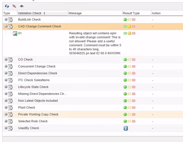

for one of my customers I've created a wizard step with some change validation info.
the data is arranged in a flat tree structure which is displayed in the treetable component.
See attached example screenshot.
One requirement is that non "green" checks are auto expanded for the user.

any suggestions maybe? what did I forget/miss? 😉

Jul 3, 2024 6:49 AM UTC
Hello @HelesicPetr
well, that's unfortunate. 😕
In the meantime I tried different approaches but so far no luck.
It seems that I would need to create some additional JS code and simulate onClick event to expand certain entries.
(Like your proposal)
