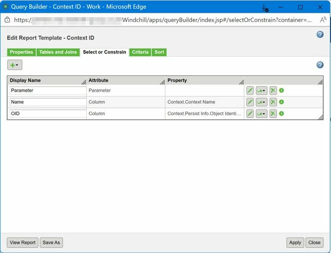

March 10, 2026
Is the report you mentioned a query builder report?
You can pass a Parameter of the report to use as a criteria using a "input" in the request payload.
const payload = {
 Task: "com/ptc/windchill/enterprise/report/ExecuteReportTemplate.xml",
 Params: [
 Value: "wt.query.template.ReportTemplate:1264666482",
 ValueSet: []
 Value: "Parameter=IT Testing",
 ValueSet: []
