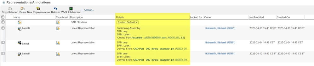

What I am missing is the Information from the Details column in the Representationn/Annotations table on the Part Information Page. (see attached picture) Is there a other Rest Service API to get the information (Positioning Assembly / EPM only /EPM latest / Derived/Copied from)?

This requires deep investigation and eventually R&D involvement, I suggest that you raise a support  case with tech support and we will be glad to assist you .

I don’t see any OOTB REST service that returns the required details.
A custom REST service will need to be implemented.
