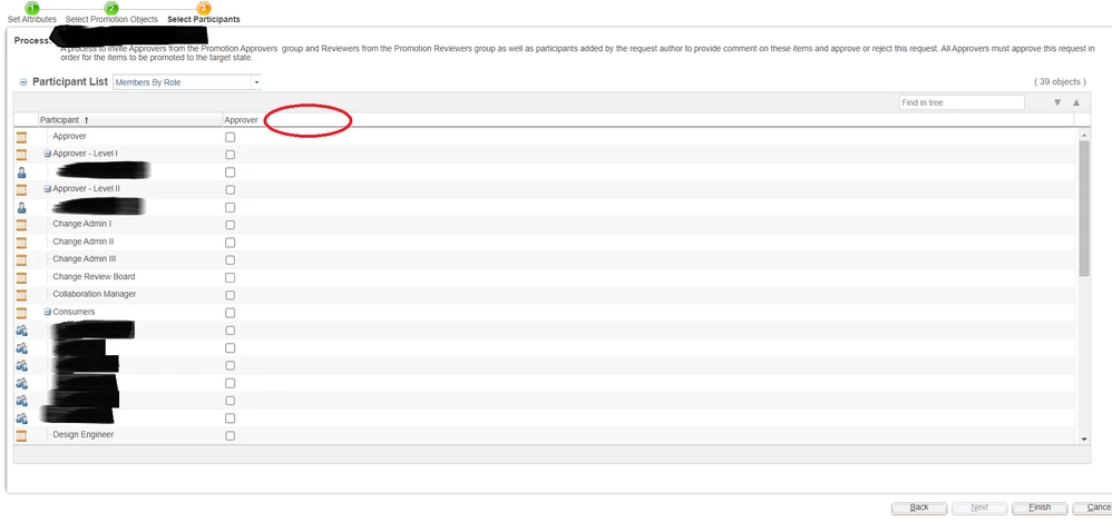

Hello Everyone,
We are trying to implement a "Staggered" Approval Promotion process in Windchill. Apart from "Approvers", the workflow must also include "Reviewers" to be aware of the objects being promoted, but not need to perform any actions. I have added a couple of "Review" tasks similar to what was available in the OOTB "Two Level" Approval Process. However, even after adding all the necessary participants for the respective "Review Tasks", I am unable to view the "Reviewer" column in the "Select Participants" window of a Promotion Request.
How could I achieve this?
BWorkflowWorkflowNew_Promotion_Request.pngBest Regards,
Irfan
Best answer by HelesicPetr
Hello @MIK_203
I can see that the users are already selected.
This means that configuration in the Preference Management the "Fixed Roles For Promote " is set
If the preference is set then the roles are preselected and you can not change it.
PetrH

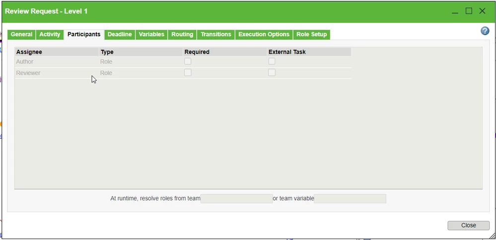

Hello @MIK_203
Where the "reviewer" role is defined? in which Task? If the "reviewer" role is not used in any task, then it can not be shown in the table
PetrH
MIK_2034-ParticipantAuthor
May 24, 2023
Hello @HelesicPetr ,

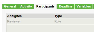

Both "Review Tasks" as you see in the Workflow include the "Reviewer" & "Review Manager" as participants.
Attached a snapshot for reference.
BR, Irfan

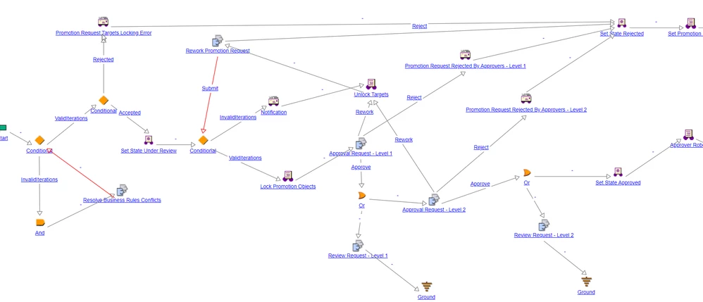

Then do you really use the correct workflow?
In the Process I can not see if you use the correct FW process or another one. Check it.
Also you need to check if there is not same workflow template on lower level that can rewrite the upper wf.
For example, you defined WF template on the organization, but you also try to create and change same wf on the site level
 change on site lvl can not be applied because it can be rewrite by org level template
Don't forget check in wf template
