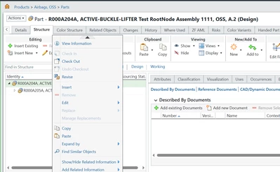

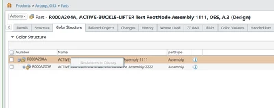

On the Part Structure Tab, when we right click on a Part, we see the Actions. I want to implement the same on the Parts that are getting displayed on the my custom Tree.
Desired outcome:
The Output I am seeing :

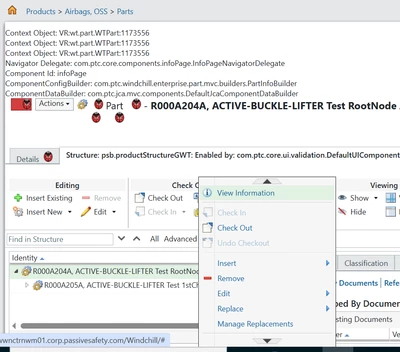

One doubt. I tried to do jcaDebug to find the Action model used in Part Structure for the Parts. It does not show me the model name. How to get this ?
