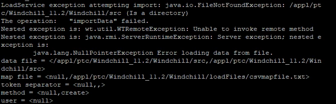

Hi, I am facing this error while loading a file into the server. Can anyone help me with this.
Best answer by avillanueva
The error is with your path to the file for loading. That is what its complaining about. Looks like you forgot the filename.

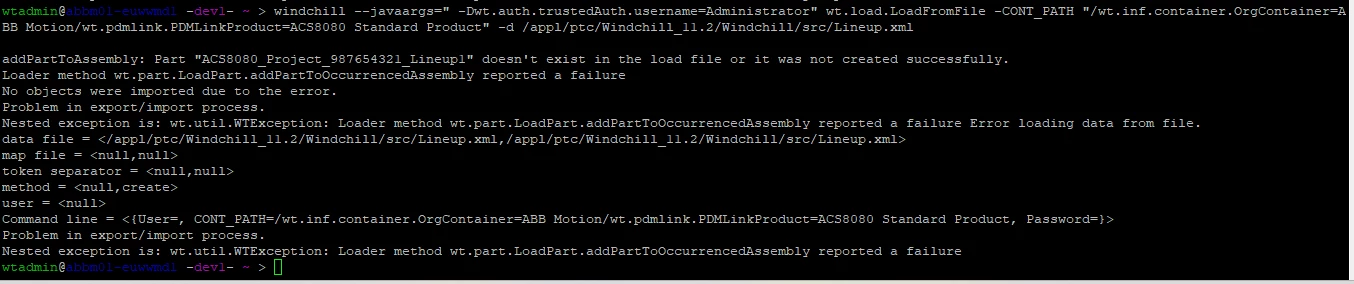

Thanks for pointing that out, but when I am trying to load the file after correcting the path, its throwing an error like this -
The part is present both in the file and the server.

Hi @AbbmotionPLM
The part number does not exist in the Windchill
