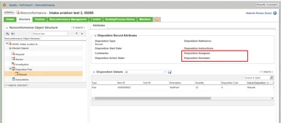

Hi All,
I have created two custom global attributes of type String on Disposition Record and assigned default value
Disposition assignee and Disposition reviewer
But I'm not able to see in UI on Disposition Record Attribute Layout
