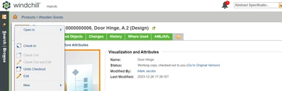

Hi @Divyanshi
Have you restart the server? Or have you used a reload actions? HelesicPetr_1-1704786137262.png
There is no issue, you just need to set a label in the custom-actions that the name is shown.
I use your config and I don't have any problem with the action
<action name="openInGoogle">
<description>Open In Google</description>
<label>
	Open In Google
</label>
<command windowType="popup" url="https://www.google.com/" />
</action>
